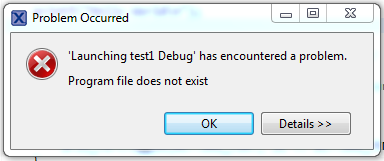

Hello guys,
I'm trying to make first 'blinky' project with MCUXpresso. Unfortunately I stuck over debugging starting, i got 'Program file does not exist' error:

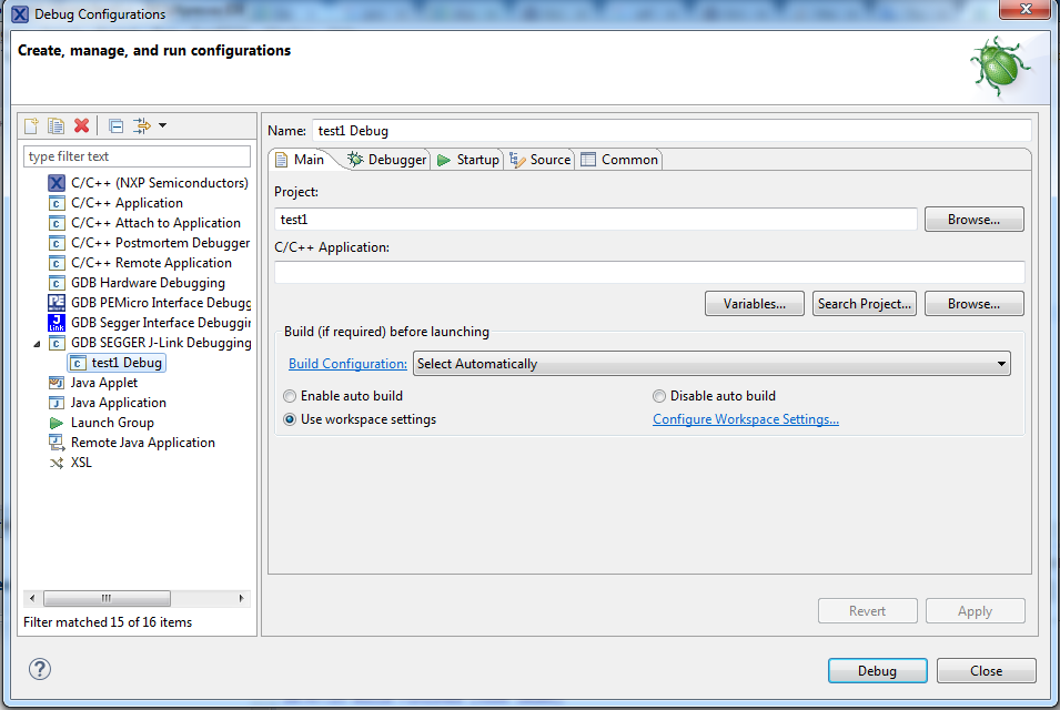

My debug configurations below :

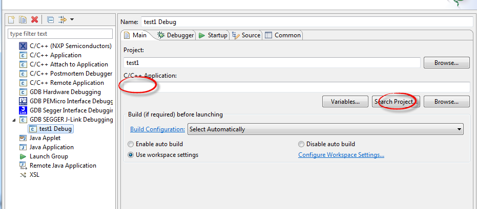

Somehow in your launch config the binary file to debug is not specified:
Use the Browse button to select the .axf file and you shall be able to debug it.

lpcxpresso_supp
How did you try to start the debug session? Did you use the Quickstart Panel's "Debug" button which will trigger the IDE's probe discovery and automatic creation  of the launch configuration?
If not, I suggest that you delete any .launch files from inside your project. Then try using the Quickstart Panel "Debug" button.
For more details, please see the supplied MCUXpresso IDE v10.1 User Guide - in particular  chapter 3, "Debug Solutions Overview" and chapter 10, "Debugging a Project".

BlackNight
