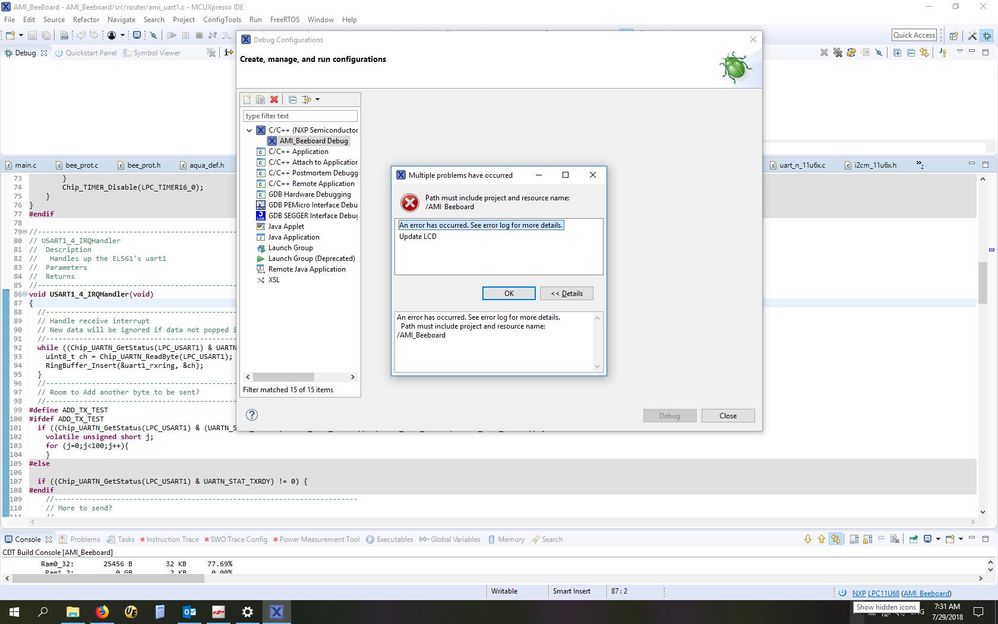

With MCUXpresso IDE v10.2.1_795 and also the previous version after building a debug project, I try to debug the program but the IDE gives an error when clicking to add a debug configuration. I cannot even open the debug configuration to try to edit it. My projects was created with previous MCUXpresso IDE versions.
I get an error after I click to create the debug configuration.

Hi David,
There are indications from your screenshot that you are using a workspace from an older version of MCUXpresso IDE. Please be sure to use a new workspace and then build the project before attempting a debug operation.
