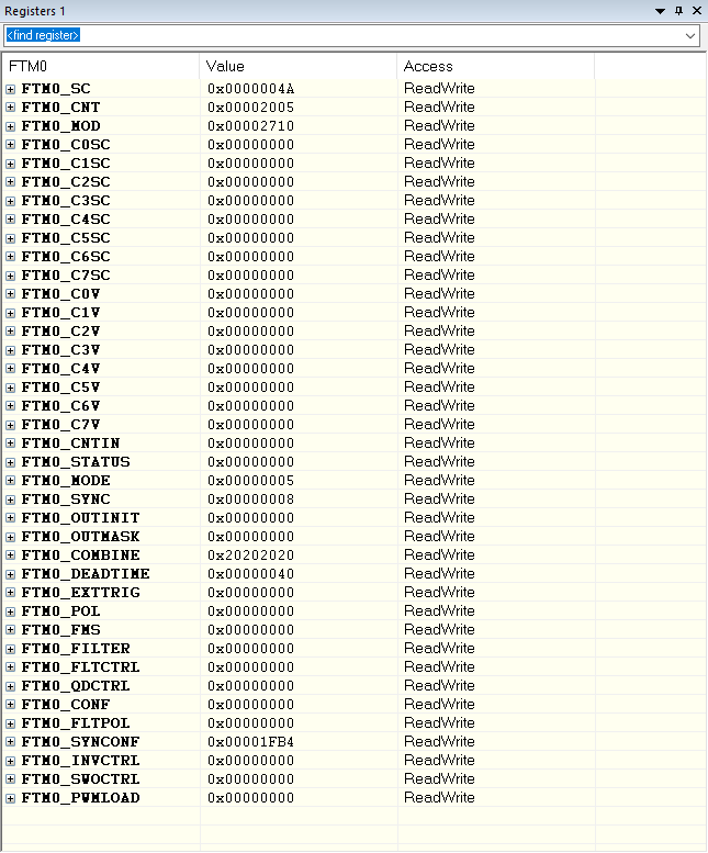

tonytao
Hi Mike,
Appreciate your effort, that is the tough part.
Please see the attached pictures. All those pictures come from a non-working project.
FTM0 Registers.JPG: FTM0 is working.
Main.jpg: Interrupt handler is not working.
Peripherals Head file.jpg: it defined FTM0_IRQn & FTM0_IRQHANDLER already. But I used FTM0_IRQHandler directly.
Interrupt print.jpg: Add the printf in the interrupt handler, to make sure the code does not get in the handler at all.
#define added.jpg: even I added the define in the code, it still not working.
I imported the SDK example code, and it is working!
But any new project I created had a problem with FTM0. I do want to create a CPP project, but the example code is a C project……

Hui_Ma
For you could run SDK demo without any problem, there shows the hardware working.
Then it need to check the software code.
I think that could be registers setting difference cause the issue.
I abstracted the working projects FTM0 registers and core NVIC registers values for your reference:
Please check if your C++ project also has the similar values of those registers.
Wish it helps.
Mike

tonytao
Hi Mike,
Thanks for your responding.
Unfurturnly, the FTM0 still not working. Detail please see attached screen captures.
