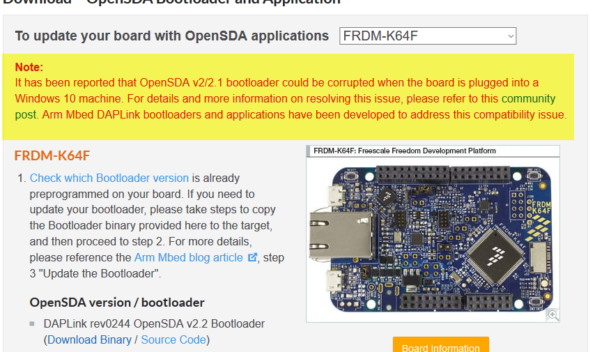

3) On FRDM-K64 , there is on board debugger OpenSDA, you can directly use it . Just plug in USB to OpenSDA port
with PC, under "Ports" will show debug probe. There are three debug probe can use in OpenSDA, you can switch
refer to you requirement , about detail please have a look at: OpenSDA Serial and Debug Adapter | NXP
If your PC is Win10, pay attention the Red text this link mentioned .

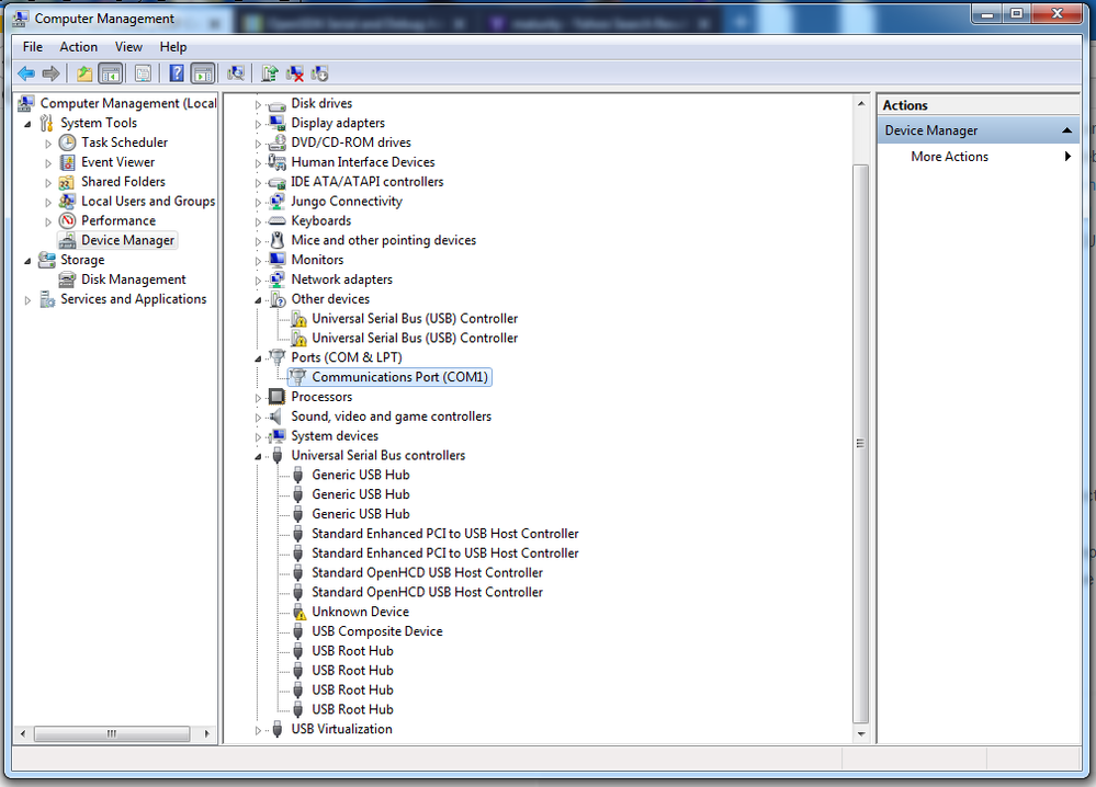

I found the communications port under Ports (COM & LPT) as COM1 (See below).

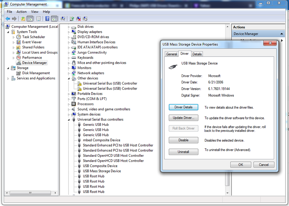

Under USB there is an "Unknown Device" which turns out to be the mbed Composite Device once the board is rebooted. The E: drive also becomes available.
It still says Link Server is not found while debugging. I also see a dialog:

Do you used MBED debug ? Please install the driver:
https://os.mbed.com/handbook/Windows-serial-configuration

-> If your board is FRDM-64, this action is force debugger on board run into bootloader mode, then we can update
debugger firmware, for example J-link, P&E, MBED. About detail steps please refer to : OpenSDA Serial and Debug Adapter | NXP
3)Now, I recommend you update it to J-link debug probe refer to above link,  in my experience, sometimes it can't work
well MBED on FRDM-k64 .  Remind again, if your PC is WIN10, pay attention the notes:
4) If still can't debug , please take screenshot show your steps.
