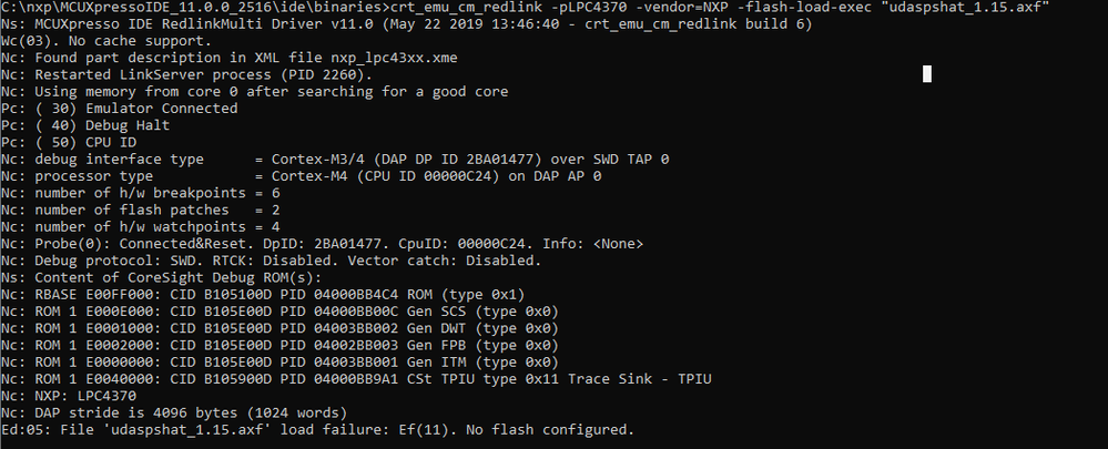

Thanks for the reply. The link you provided helped me a lot. But I am again hitting a road block. I am getting error (Ed:05: File 'udaspshat_1.15.axf' load failure: Ef(11). No flash configured) when I try to flash my mcu with cmd line tool but the same axf file works with gui flash programmer. I looked at thread  Version 8 can't flash (no flash configured)... Could with v7.5, but its unclear what the error means in my case.
 Note: I am using LPCxpresso LPC-Link2 Rev B (LPC-Link2 | NXP ) and trying to flash MKV31F mcu

Where did you get that command line from? The command line (-pLPC4370 -vendor=NXP) is for programming an LPC4370.
If you have a working GUI Flash configuration, all you need to do is "Just copy flash command to clipboard" and the command line command will be in your clipboard.
EDIT: Also take a look at chapter 14 in the User Guide, where it describes the Command Preview which shows the exact command line and any setup you need to do, to run it.
