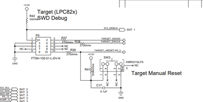

I have the LPC824 MAX board.
Is possible to use the programming part an simply connect "Target_SWDIO", "Target_SWCLK" and target_nReset" to another MCU like LPC844 on a different PCB through the P5 connector of the LPC824 MAX board?
Thank you
Thomas
2,399 Views
ErichStyger
Specialist I
I think you would have to disconnect/silence the LPC845 on the board for this: either remove it or at least keep it in reset.
But why doing this? You get for $10 the NXP MCU-Link debug probe: New MCU-Link Debug Probe from NXP | MCU on Eclipse
Much easier, and more versatile an universal.
I hope this helps,
Erich
