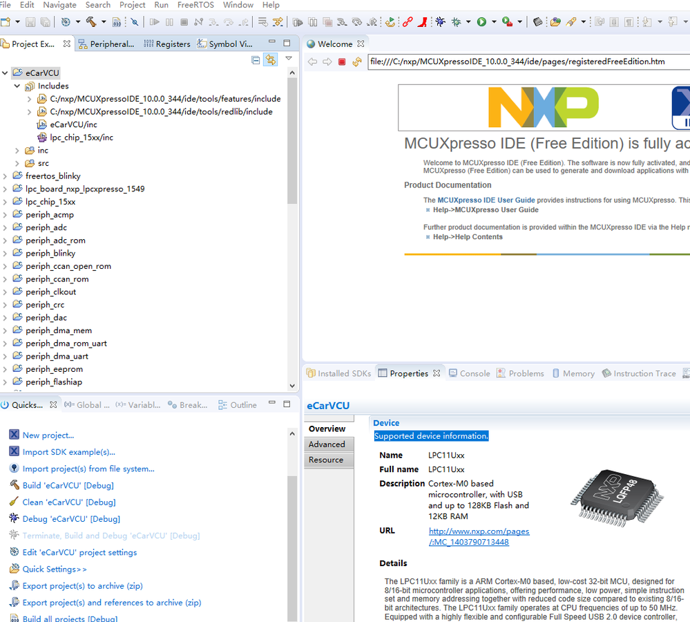

When creating new project for LPC1517 (Cortex-M3) using  LPCOpen-C Project Wizard pre-installed, after completing  process of creation,I click the Project Name in the Project Explore, the information is incorrect in the Tab of Project Overview:
Supported device information.
Name           LPC11Uxx
Full Name    LPC11Uxx
Description  Cortex-M0 based ......
How to resolve this problem?

Replicated. Seems to be related to pre-installed parts where there is no exact board match. We'll investigate.
Note that this only affects the information displayed in the properties view - not the MCU configuration itself (as used for building/debugging the project).

Thanks for your rapid response.
Now that the questions may not result in any deviation in project, all the worries disappear。
