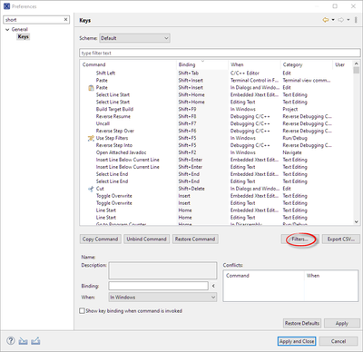

On Windows, AltGr creates the Ctrl+Alt code (https://en.wikipedia.org/wiki/AltGr_key). In Polish, AltGr+L gives "ł" ("Ł" with Shift). In MCUXpresso, both shortcuts are used and are not listed in the settings (Windows -> Preferences -> General -> Keys). How can I unlink/disable these shortcuts so that I can type "ł" or "Ł"?

Hi @mosiniak ,
I assume you are using 11.2.1 ?
Go to the Preferences and press the 'Filters' button:

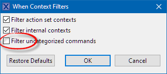

Disable the uncategorized filter:
Then you can change the binding for  AltGr+L (which is in fact Ctrl+Alt+Shift+L):

mosiniak
Thank you for your help. It worked.
I am using version 11.2.1.
Unbinding Ctrl+Alt+ L worked immediately, while Unpinning Ctrl+Alt+Shift+L worked after restarting MCUXpresso.
