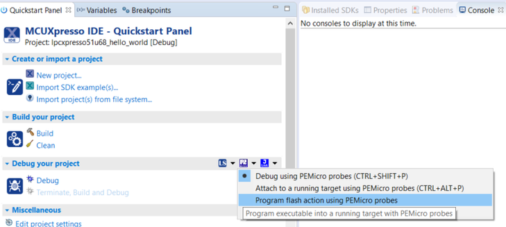

Dear All,
I'm working with MCUxpresso 10.2, SDK 2.5.
I'm trying to config "Run" to only download and run... But I didn't find the solution.
I can debug (download and debug) and after stop debugger and so board runs the program, but it is very slow ...
So, What is the way to Run program (download and run)? For example, CCS has this option.
Thanks!
Jordi

Responding here as it seems Jordi didnt get a final answer. The Quickstart panel includes a shortcut to program and run the target with the currently selected project. I believe this was introduced in 10.2, but there was a bug fix in 11.0.1 related to it. See https://www.nxp.com/docs/en/user-guide/MCUXpresso_IDE_User_Guide.pdf Section 11.3.1). You just need to select the "Program flash action" option, then every subsequent time you click on the PE server icon it will program the target then reset it (thus running it) without connecting a debug session.

Alexis_A
Hi Jordi,
I found very strange that you could not use the MCUXpresso programming only option. Maybe this is due your using a MCUXpresso previous version, could you try updating to the latest MCUXpresso version?

jordi_becares
Hi Alexis,
thanks! Your solution works! I don't understand why older versions don't work.
I checked with MCUXpresso IDE v11.0.1_2563 and Multilink FX and Gui Flash Tool works.
But... I enabled  "Reset target on completion" but device not run after program. I have to do hand made reset....
Any idea?
Jordi

Alexis_A
Hello Jordi,
The board that you're using is one the FRDM boards or is a custom board? In the case the board is custom, check if in the SWD connector the reset is connected correctly.
