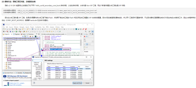

Please refer to only this link:
痞子衡嵌入式:MCUXpresso IDE下在线联合调试i.MXRT1170双核工程的三种方法 - 痞子衡 - 博客园 (cnblogs.com)
And also,Please import SDK demo as follows.
SDK_2_16_000_MIMXRT1170-EVKB\boards\evkmimxrt1170\demo_apps\hello_world_secondary_core_boot\cm7
SDK_2_16_000_MIMXRT1170-EVKB\boards\evkmimxrt1170\demo_apps\hello_world_secondary_core_boot\cm4
In the link, 2.3 chapter describe what you want to realize.
