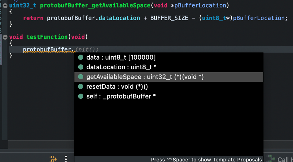

Annodizer
Hi Alice, thanks for the reply but that's not what I'm asking. I didn't do a very good job of explaining myself!

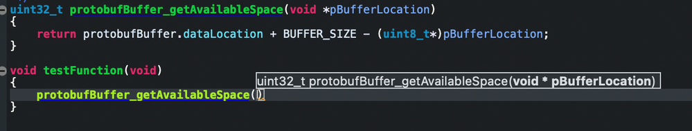

What I would like to see is the parameter list for a member function. When I define a function I can hit ctrl+shift+space to bring up the parameters that the function is expecting to receive as in the screenshot below.Screenshot 2024-08-26 at 14.21.10.pngScreenshot 2024-08-26 at 14.21.10.png
When I use a function pointer within a type to point to this function so i can access it through dot notation I can see the function pointer definition showing me that it returns a uint32_t and accepts a void pointer as in the below image but it doesn't show me the parameter name as declared in the function declaration.

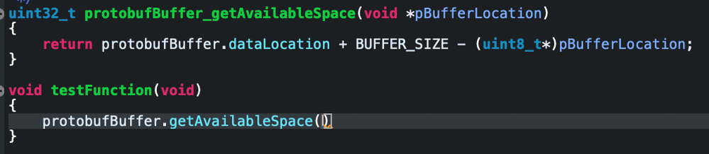

My question is, is there a way to get the same function parameter list as when you call the function directly, when you access it as a member function of a struct? Pressing ctrl+shift+space at the point shown below does not show the functions expected parameters or give any other assistance. Hopefully that makes it a little clearer?

1,521 Views
Hello @Annodizer
Thanks for your detail description. I know your meaning know. While sorry for the  function pointer, can not show the  parameter. Because the pointer just points to the address of function, does not include the parameter information.

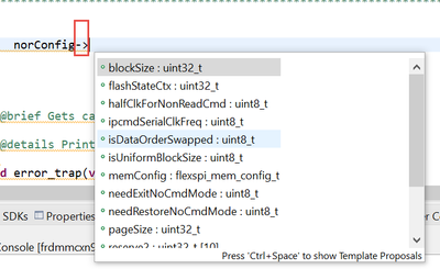

1,589 Views
Hello @Annodizer
I'm not sure understand your meaning. If you want show the member of structure, please use "." or '->' as below, members will be showed automatically.
Alice_Yang_2-1724041332512.pngAlice_Yang_2-1724041332512.pngAlice_Yang_3-1724041338034.pngAlice_Yang_3-1724041338034.png
Please describe more detail is this is not your need. Thanks.
