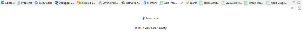

Hi everyone,
I'm having a trouble in debugging a simple FreeRTOS project.
I'm using a MIMXRT1024-EVK board, MCUXpresso 11.5.0 and SDK 2.11.0.
The program is working fine, when I pause debugging, the debug view displays all threads, but no task is displayed in the FreeRTOS task list view; in all other FreeRTOS views are correctly displayed (except the timer list view, but no timer is created in my program, so I think this is the correct behaviour).
What do I have to check to correct this issue?

Yes, you only will see something in the Timer view if there actually timers running by the application.
As for the Task views: Can you check the console view output? Usually it reports the issue there.

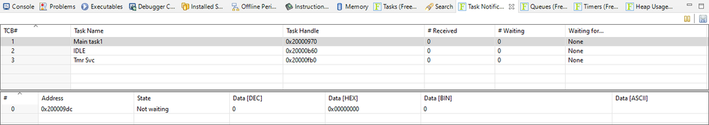

I found the reason, in my FreeRTOSConfig.h there was:
#define configENABLE_BACKWARD_COMPATIBILITY 1
Now I've modified as:
#define configENABLE_BACKWARD_COMPATIBILITY 0
And it works.

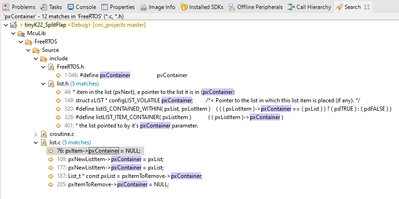

In FreeRTOS.h there is this code:
#if configENABLE_BACKWARD_COMPATIBILITY == 1
    #define pxContainer pvContainer
#endif /* configENABLE_BACKWARD_COMPATIBILITY */

pxContainer is an internal struct field inside the kernel, or better: it is used for the kernel lists. You should be able to see this your grep the RTOS sources:
There could be multiple reasons why it is not able to find it. Most likely you are using an older RTOS (I believe in older FreeRTOS versions that field name was different). In order to have the plugin detect and deal with different RTOS versions, it needs to know this with e.g. with the file freertos_task_c_additions.h which you should have present in your project.You can see this file for example in https://mcuoneclipse.com/2020/05/31/tutorial-adding-freertos-to-where-there-is-no-freertos/  or here: https://github.com/ErichStyger/McuOnEclipseLibrary/blob/master/lib/FreeRTOS/Source/include/freertos_...
