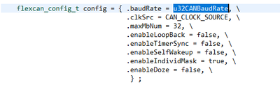

I am using KW36Z, when i set all pass filter in CAN all the transmit frame is reflected back in receive FIFO. is there any way to stop this from driver level.

This could also be caused by your device sending data back, could you please confirm if all your nodes are different devices? Or are you testing this project with various KW36Z?
Also, please confirm if Loop Back Mode (LPB) is enabled, as this could be another cause.
As an alternative, you could set up a filter that ignores the frame when the ID of the frame matches the ID of the FlexCAN MB. You may filter out self-received frames on hardware level by configuring ID masking (Rx Mask Registers RXGMASK, RX14MASK and RX15MASK).

I reviewed your code and it appears the register activation for SRXDIS is not present, or at least I couldn't find it, have you removed it once you confirmed it didn't work? Or is it present somewhere else?
Best regards, Julian
13,721 Views
pdnr7
Yes, I removed SRXDIS after setting and testing it.
