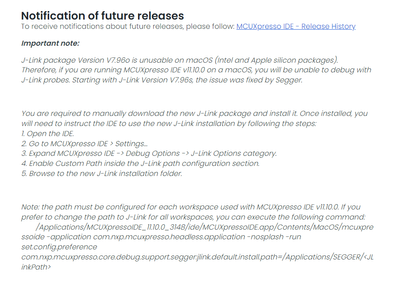

Kind All,
I'm a student tying to debug the first led_on-wait-led_off test exercise with MCUXpressoIDE. I'm using the software on my MacBook Air 8Gb M2 Sonoma 14.16.1. My J-Link debugger setting as default: I'm using the device MK22FN512xxx12 with Target Interface SWD connected via Bus USB 3.1. All the other students in the course are using same code/default setup/on Windows without any error, unfortunately me and another guy using Mac, every time we try to debug the project, we receive the related output:
Error in final launch sequence:
Failed to execute MI command:
-target-select remote localhost:2331
Error message from debugger back end:
localhost:2331: Operation timed out.
Any help is greatly appreciated, thanks a lot!

Please see the "Important note" here: MCUXpresso IDE v11.10.0 Now Available - NXP Community
Adrian
