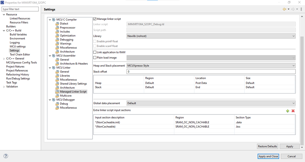

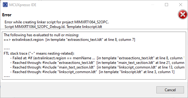

I was working on a project and all was fine until I restarted mcuXpresso and then I have this error anytime I tried to build my project. I tried to restart MCU, clean the project, rebuild, I always end up with this error and I have no idea why

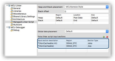

Double check the name of your memory regions (in the Memory Configuration Editor) against the values in the "Extra linker script input sections" fields. It looks to me like you probably have a mismatch.
If you use the dropdown in the "Extra linker script input sections", the IDE displays the available set of memory region names, at that point in time. But if you then edit the memory region names, things can get out of step unless you reselect.

I haven't done any changes to the project settings, the only things I've done is adding files to compile and include path. I do this from a base project, both the base project and the project I am working on have the same linker configuration :
The base project compiles without troubles, the new one was fine until I added a source path and this error happens. I tried to delete the source files I added but it doesn't remove the error

This probably what I will have to do. I don't have this problem when I compile in RELEASE mode, and in debug, there is a linker file that is not correctly created: two sections `.TEXT` are created  and the second one is not properly formated: I have those two lines at the end of the file MIMXRT1064_S2OPC_Debug.ld:
.text : ALIGN(4)
and the `SECTIONS` block is not properly closed

It was that, the section names were not the same, I don't why I never touche memory in this project, I only add source path and include path

Sounds like you have a problem with whatever entries you have got in the "Extra linker script input sections"  field of the IDE's Managed Linker Script setup. Check section 17.13.1 "Placing code and data into different Memory Regions" of the MCUXpresso IDE v11.3.0 User Guide:
