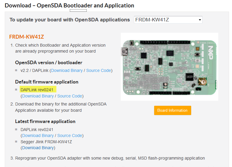

ZhangJennie
You met board connection problem.
to confirm if this problem is on firmware side,I suggest you update your board firmware then test again.
OpenSDA Serial and Debug Adapter|NXP
I suggest you try DAPLink rev0241
Can this firmware fix the connection problem?

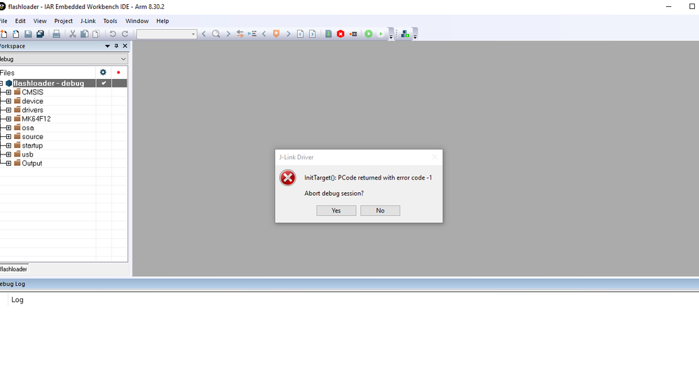

nxf42424
Hi I have tried on the TWR-K65F120M platform, but it will produce this result!
I downloaded this.
