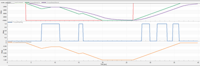

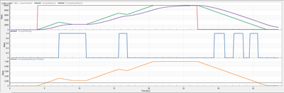

I am implementing a DRamp functionality with RTCESL version 4.62, where I have issues with the saturation when the absolute ramp value is falling.

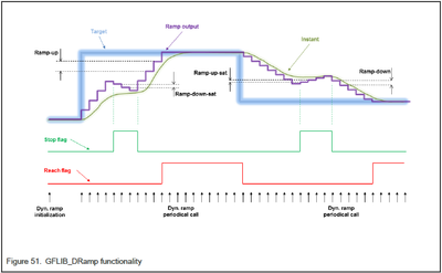

According to the documentation, the stop flag causes the ramp value to turn back towards the given instance, but this does not work in the implementation I did.
I tried both. A ramp with positive request and a ramp with negative request.
Is there a known issue or any other reason, the ramp does not respect the stop flag?

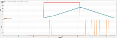

I tried the ramp using RTCESL 4.8.1 for CM33F, but the result is the same.
The saturation only works while the absolute ramp value increases.
