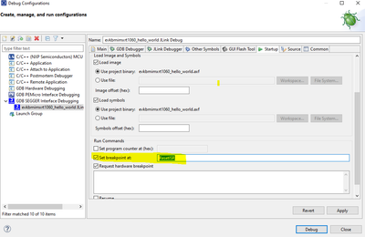

    • First breakpoint appears to be the hardfault handler. Pressing play halts at the same line. console output below. Look for WARNING: Failed to read memory @ address 0x10D7263A
    • No start breakpoint hit. Pausing shows the PC is in bootrom (0x200000 range). I know the boot mode is set correctly and can prove it if you aren't satisfied. Using serial download mode to erase/program does not fix it.

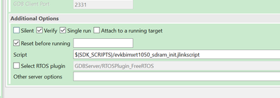

    • Does not work with the "Reset before running" box checked in the “J-Link Debugger” tab of the debug configuration. I believe this option is supposed to be ignored for RAM configurations.

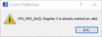

    • Runs to main. Press run and pause work debugging appears normal for a very brief time, then pausing moments later shows the PC in bootrom

    • Debugger "halts" at 0xdeadbeee. Pressing run goes to main and then I can debug normally (this also happens in MCUxpresso 11.2.1)
    • Using my work arounds and finally being able to debug - cannot restart a debug session with the Restart button. Hitting restart appears to do nothing only that the program is "running" because the pause and stop buttons are active and the play button is grey. Hitting pause usually shows the PC at the same location repeatedly.

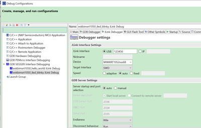

  • I've tried deleting and recreating debug configurations every way I know how: Quickstart > Debug, right click project > Debug As and using the debug configuration to add a configuration

  • Deleting the “monitor reset” command in J-Link debug config settings

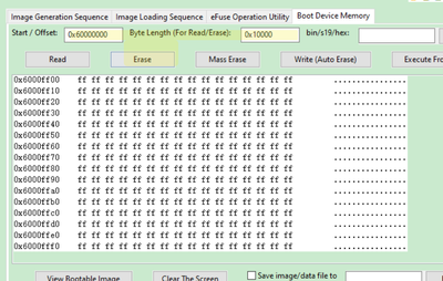

  • Using JFlash, erased flash and verified all 0xff's, then try to debug. Doesn't help
  • Use the MCUBootUtility to erase/program the board. Programming and erasing works but debugging has the same issues.

  2. MIMXRT1060-EVK board do the mass erase at first.
    You can enter the serial download mode, then use the MCUBootUtility tool to erase it.
Just make sure the external memory is clean.

  1) debug result, include the breakpoint, reset button.
  2) JLINK debug configuration
to helloworld, it contains the JLINKSCRIPT for SDRAM

  • It seems a lot of scenarios revolve around the use of SDRAM. Being board memory external to the MCU, this RAM block must be initialised before it can be used. An XIP Flash header contains the DCD data for the BootROM to use to initialize this RAM memory. Alternatively the project specifies a debug jlink script that initializes this SDRAM.
Make sure the SDRAM initialization sequence in the script is correct (matches the intialization via DCD). Otherwise, it may explain why it works in one case and doesn't work in the other case

To you customer board can't test the SDK code again, you can use this code, run in RAM:
SDK_2_11_1_EVK-MIMXRT1060\boards\evkmimxrt1060\driver_examples\flexspi\nor\polling_transfer
Change the erase location from 0X60000000, this also can realize the mass erase.
After erase the external flash, your customer board should can works again.
Any updated information, kindly let me know.
