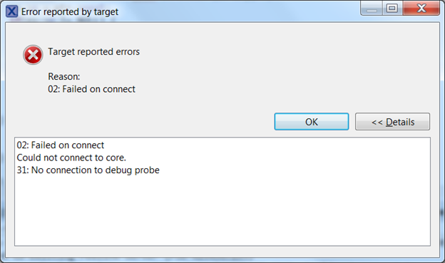

I have the FRDM-K64F board, and have been able to successfully build and run the Hello World demo on it. I've also been able to modify the code, and recompile it, but every time I terminate the debug session I am unable to restart it again without disconnecting the board and reconnecting it again. This is quite inconvenient!
I get a console message like this:
MCUXpresso RedlinkMulti Driver v10.0 (Mar 21 2017 01:34:42 - crt_emu_cm_redlink build 190)
Reconnected to existing redlink server (PID 4294967295)
Connecting to probe 1 core 0 (server PID unknown) gave 'Ee(36). Could not connect to core.'
Server OK but no connection to probe 1 core 0 (after 3 attempts) - Ee(36). Could not connect to core.
Failed on connect: Ee(36). Could not connect to core.
No connection to debug probe
I presume this isn't the way things are supposed to work? What am I doing wrong?

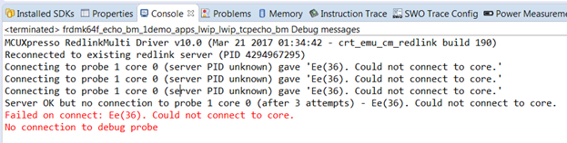

Fail debug probe connection.pngFailed on connect: Ee(36). Could not connect to core.

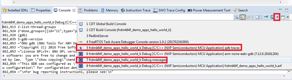

4 - Start up MCUXpresso IDE and perform a debug operation, then capture the debug log and paste it to this thread. You can capture this from the Console -> Display Selected Console -> <project> Debug Messages

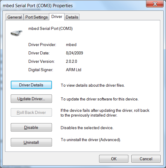

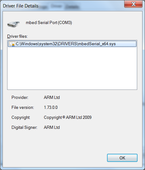

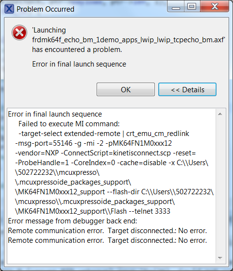

Hello everybody.  I have also run into the same problem with the FRDM-K64F board.  I'm building and running the tcpecho example demo for the FRDM-K64F.  It builds successfully, and will start and run in debug mode successfully the first time I run it.  The demo program also works as I'm able to putty to the echo server and have it echo back to me.  When I kill it and try to restart again (in debug mode as before), that's when I run into the issue.
I have attached a series of pictures below to help provide some information as to what my system is running.

anthony_huereca
Can you confirm you both have the latest MBed serial driver installed (it needs to be installed while the board is plugged in): https://developer.mbed.org/media/downloads/drivers/mbedWinSerial_16466.exe
21,988 Views
JamiePegg
Hi Anthony,
That is the serial driver that I have installed.
