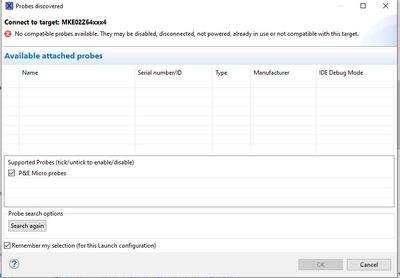

Hi Converse, Please tell me how to delete the existing debug configuration. I see the blue Debug under build your project to create a new debug session as in your picture.
When choosing the blue debug icon, the process of connecting to debug gets stopped searching for the debugger probe.  A dialog box says, "No compatible probes available."
The P&E debugging probe is connected to my computer.  I tested the P&E probe on a computer out back and it could program.  When connecting the probe to my computer, I hear the same P&E connection tones I always have. The blue and yellow LEDs on the P&E Multilink Universal.  The computer seems to know my probe is connected, but MCUXpresso cannot find it.

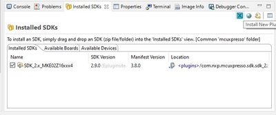

I have successfully tested out the program and debugger with MCUXpresso v11.3.0 on the final test computer in the production area. Then I updated the MCUXpresso software to v11.3.1.  Then the SDK 2.9 was added for MKE02Z64xxx4 use. the code was cleaned and compiled.  The refresh debug as performed, shift, blue bug.  After this the P&E probe could not be found when trying to debug.
With the same result from two different computers, the problem seems to be with something I did or with the software install.  I installed a processor SDK but not a board SDK file. The SDK file was added at the screen below.  I am using the processor MKE02Z64VLD2.

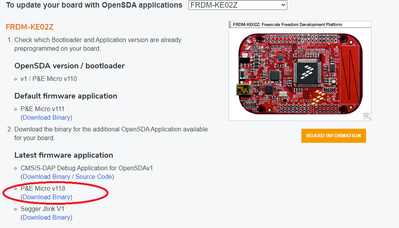

Hi  @Kratz :
Please check your device manager,  there should be a OpenSDA port  .
 I would suggest you update your board with latest firmware application
The latest firmware can be downloaded from below link.
https://www.nxp.com/design/microcontrollers-developer-resources/ides-for-kinetis-mcus/opensda-serial...
you can try it again after you update your board's latest firmware.
