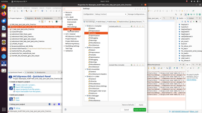

Hi fellas ,
I've converted project into C/C++ like this and I checked MCU C++ Includes are completely empty as attached below img..
Screenshot from 2023-11-08 15-10-57.pngScreenshot from 2023-11-08 15-10-57.png
Whether we should add an C++ Includes? - as its empty ash shown below..

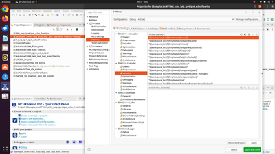

Screenshot from 2023-11-08 16-32-27.pngScreenshot from 2023-11-08 16-32-27.png
Yet the C Include files remain intact - as shown below...

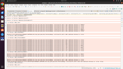

Screenshot from 2023-11-08 16-32-40.pngScreenshot from 2023-11-08 16-32-40.png

HI GanesanGuru
There are erpc related SDK demo code which includes C++. for example lpcxpresso55s69_erpc_matrix_multiply_rpmsg_cm33_core0
I think you can refer these C++ demo to configure your C++ project.
