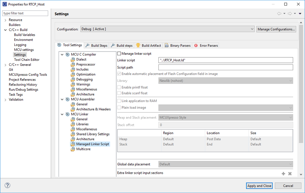

I'm trying to manually manage the linker scripts for a bootloader project, and I'm having a problem with changing the linker script location.
Since all of the configurations (Debug / Release /etc) for my project use the same linker scripts, I want to put them in main project folder.  By default, the linker scripts get generated in the configuration (Debug/Release) folder.  I'm moving the linker scripts up one directory.
I went into the project properties->C/C++ Build->Settings-MCU Linker->Managed Linker Script, unchecked "Manage linker script", put the name of my linker script in for "Linker script", and set "Script path" to "..\", like so.
That's the only thing I changed in the project properties.
But now the project fails to build with the following error:
arm-none-eabi-gcc.exe: error: RTCP_Host.axf: No such file or directory
I thought the "Script path" only changed where the linker went looking for its script.  Apparently this is not correct.  What exactly does the "Script path" setting change?  And how can I change the linker script location without changing where the output file gets located?

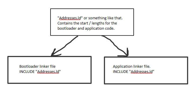

The reason why I turned off the managed linker script mechanism is to keep the start addresses and lengths of the bootloader and application images in the same space.  If I used the Memory Configuration Editor in the project settings, it would be REALLY easy for a developer later on to change an address or length in one project (application or bootloader) and forget to change the addresses in other project.
I have a common linker file that is included by the main linker scripts for the bootloader and application, like this horrific diagram shows:
Addresses.ld contains the following:
  __TOTAL_FLASH               = 0x00040000;
    __BOOTLOADER_START          = 0x00000000;
    __BOOTLOADER_LENGTH_BYTES   = 0x00005000;
  __APPLICATION_START         = __BOOTLOADER_START + __BOOTLOADER_LENGTH_BYTES;
  __APPLICATION_LENGTH_BYTES  = __TOTAL_FLASH - __BOOTLOADER_LENGTH_BYTES;
MEMORY
  /* Define each memory region */
  BOOTLOADER_FLASH (rx) : ORIGIN = __BOOTLOADER_START, LENGTH = __BOOTLOADER_LENGTH_BYTES
  APPLICATION_FLASH(rx) : ORIGIN = __APPLICATION_START, LENGTH = __APPLICATION_LENGTH_BYTES
  SRAM_UPPER (rwx) : ORIGIN = 0x20000000, LENGTH = 0x8000 /* 32K bytes (alias RAM) */
  SRAM_LOWER (rwx) : ORIGIN = 0x1fffc000, LENGTH = 0x4000 /* 16K bytes (alias RAM2) */
The linker script for the bootloader uses the BOOTLOADER_FLASH memory definition.  The linker script for the application uses the APPLICATION_FLASH memory definition.
This way, a future developer has less of chance of screwing up the memory locations, since the values for the start addresses and lengths are all contained within a common, shared file.  It also eliminates duplication, and duplication drives me up the wall.

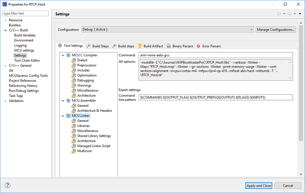

I think I figured out a workaround:
Start by changing the Command line pattern field to match the following:
And then add the relative path to the linker script name, like so:
Keep in mind that the linker script used in the "Linker Script" field will still be local to the configuration directory.  For example, this is my project directory, with a couple of other linker scripts that get included inside of "RTCP_Host.ld"
