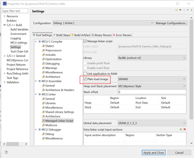

I think I found the answer.
The code was being built to run out of RAM, not out of Flash.
If I go into:
Properties->C/C++ Build->Settings->MCU Linker->Managed Linker Script
And then uncheck "Link Application to RAM" and "Plain Load Image" it appears to work.
@Alice_Yang do you know if there's something to do with the reset strategy when the software is in RAM that could affect it?
21,635 Views
Hello @andrewsglenn
"Plain Load Image" means an application that runs in SRAM. If it is checked, when reset MCU,  the boot ROM relocates application into a bank of the onboard SRAM for execution. So if the SRAM size is not enough, recommend executed directly from the flash.

andrewsglenn
My application is 107K and SRAMX is 192K. It should fit
Not that I wanted it in RAM, I wanted it in Flash so I prefer this, but I don't understand why it crashes when placed in RAM.
Can you try switching on "Plain Load Image" in your linker script and running freertos_hello to see if it fails to debug reliably?
21,615 Views
Hello @andrewsglenn
By default the "Plain Load Image" is checked. I have tested, it works well.
Alice

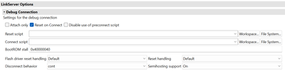

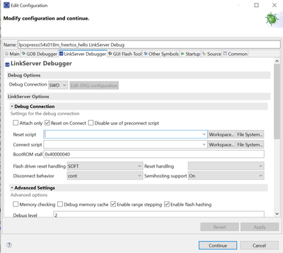

andrewsglenn
What are the correct reset settings?
I seem to have better luck with "default" rather than "soft" in that it reliably fails every other debug, rather than randomly failing 70% of the time.
I also set SWCLK, SWDIO and SWO to SWD in the pin config, but that should be default to SWD, shouldn't it?
Glenn

Hello @andrewsglenn
It is possible to download an image into the flash on the target that will then prevent any further debug access or connections. The classic cases of this are:
  • The image contains code that sets the MCU clocks up "incorrectly".
  • Not successfully disconnect before re-connect.
If do this, maybe connect failed. Recommend create a new workspace of IDE, import your project again to debug.
