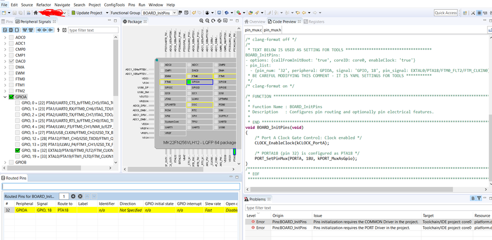

To clarify, I deleted all the base startup headers when I ported my project from KDS to MCUXpresso following BlackNight, and his tutorial. I'm not quite sure how to regenerate these files for use or even if I can.
For example for my MK22FN256 I would like to set pin 32 to GPIO and be able to toggle it in the main of my code.
The image below I believe shows me setting it to a GPIO, but I'm a bit lost on how this BOARD_InitPins function will be implemented since I removed the board file. I also am a bit lost on the actual function or command to set the pin high or low.

Hi Christopher,
the Pins tools does the Pin Muxing and not the actual GPIO driver code. The following tutorial written for an earlier (but still applicable) version of the Pins Tool should help you:
Tutorial: Muxing with the New NXP Pins Tool | MCU on Eclipse
Erich

burgeh
I understand that the pins tool just muxes the pin for it's functionality. However, it seems I cannot add in these functions since I ported in my KDS v3.2 Processor Expert project, since I need the drivers of GPIO and Port. When those are included I get errors with my imported pin functions.
So to clarify completely. Am I able to use the Pin tool or Peripheral functions that MCUXpresso uses, on an imported KDS v3.2 Project with Processor Expert. If that is so, could I please get some information on how to meld the two together nicely?
