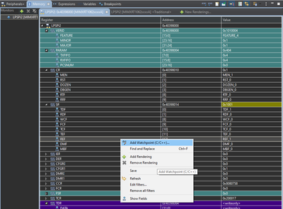

I'm trying to add watchpoints from the peripherals window. For example, to create a breakpoint when a status register changes:
I can achieve the same using the "traditional" memory renderings window... It would just be more convenient if I could add watchpoints directly from a peripheral render.

Hi @TomWilson ,
see Tutorial: Catching Rogue Memory Accesses with Eclipse and GDB Watchpoints | MCU on Eclipse,
You can use for example the outline view too.
I hope this helps,
