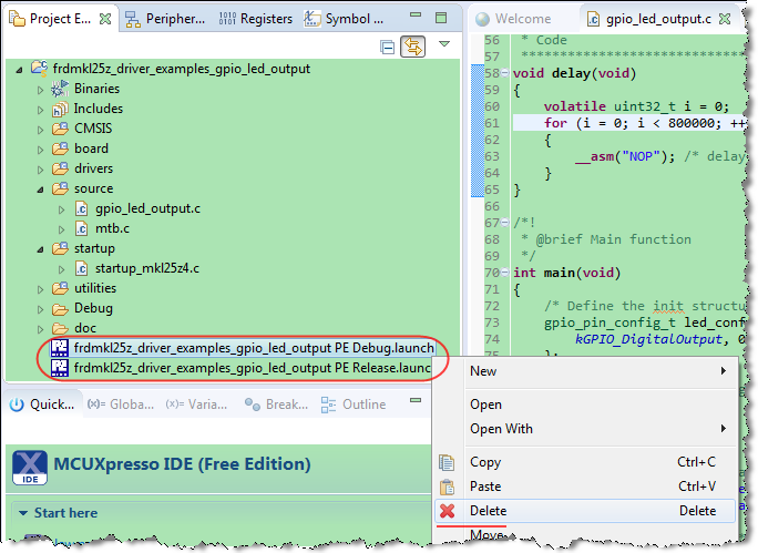

Once a launch configuration file has been created, it will be used for the projects future debug operations. If you wish to use the project with a different debug probe, then simply delete the existing launch configuration and allow a new one to be automatically used on the next debug operation.

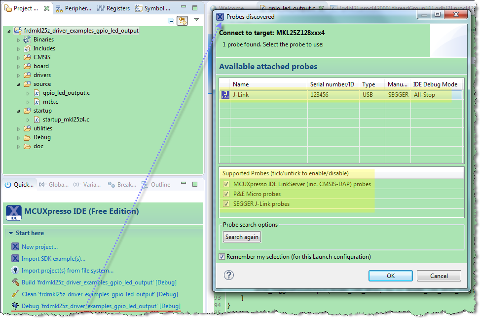

Now click debug_exc.pngblue debug icon re-trigger a full probe discovery, and it show all Supported Probes that are attached to your computer again.
