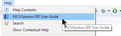

Check out the IDE documentation (menu Help > MCUXpresso IDE User Guide):

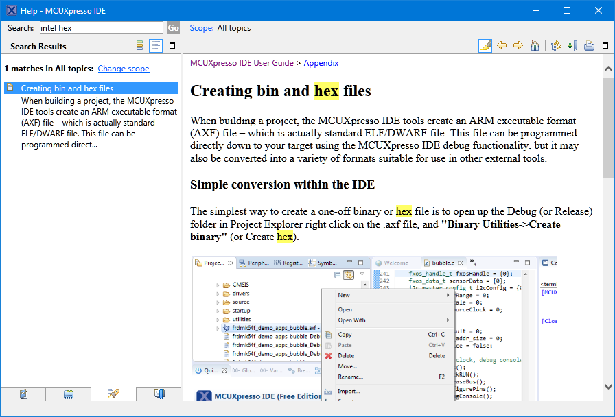

where you can search for any topics like this:
