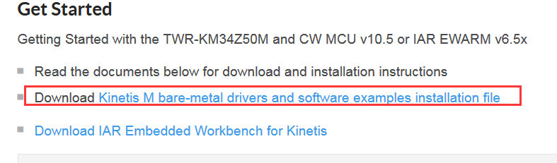

Hello Don,
You can use KDSv3.2, CWv10.7 or IAR. KDS is free.
And then  download the kinetis M bare-metal drivers to development your project.
ARM Cortex-M0+|Kinetis KM3x 50-75 MHz 32-bit MCUs|NXP
Hope it helps
TIC
