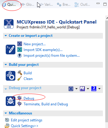

Hello Tim Boatman ,
Could you please usa a demo project to have a try ? I just test on my side , it can work well.
And use the Debug button in "Quickstart Panel"
About debug , you can also have a look at "Chapter 11. Debugging a Project -> Debugging Overview"
of "MCUXpresso IDE User Guide".
