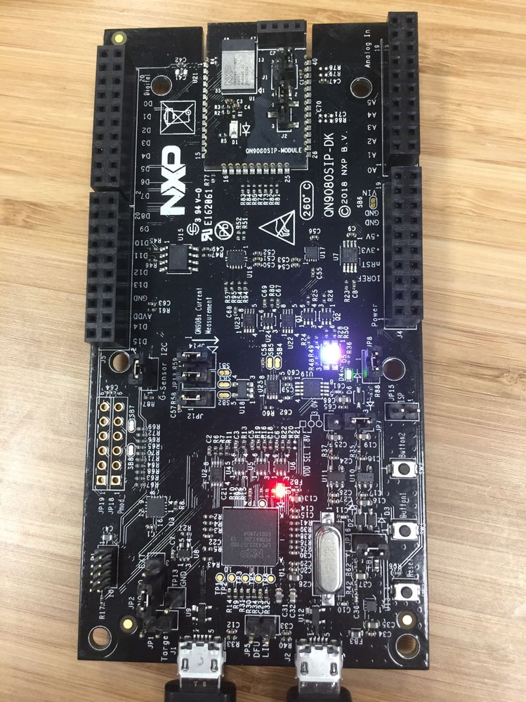

I am trying to run the SDK example for qn908xcdk_wireless_examples_bluetooth_otap_client_att_freertos. I haven't edited it and it builds correctly, however, after flashing to the board I immediately receive a SIGSTOP as seen below:
If you have seen this error before, I would greatly appreciate your help.
Below is also my board setup:

Dear Nathan,
For this example you first need to flash the framework_bootloader_otap_bm, you can use the tool available in MCUXpresso.
Select you interface, and in the following window click RUN:
After this you should be able to debug the bluetooth_otap_client_att_freertos.
I hope this helps you.

Thank you Alexis Andalon! The otap_client_att_freertos is now running.
