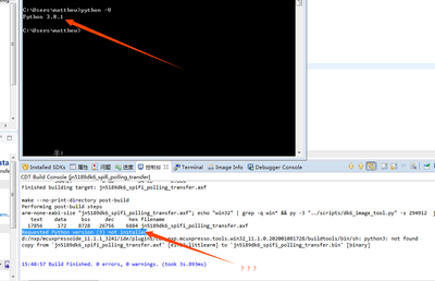

Python 3.8.1 installed, but IDE remind that 'Requested Python version (3) not installed'
5,493 Views
zengfs
I can check the python version in cmd, but IDE still remind me that the python3 was not installed.
5,399 Views
Xiang_Li
From the project setting, there is a post compiling command:
echo "${OsType}" | grep -q win* && py -3 "../scripts/dk6_image_tool.py" -s 294912 ${ENV_IMAGE_TOOL_OPTS} ${BuildArtifactFileName} || python3 "../scripts/dk6_image_tool.py" -s 294912 ${ENV_IMAGE_TOOL_OPTS} ${BuildArtifactFileName}

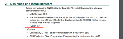

So clearly it asks for Python 3. Not Python 2.7. This is a good thing I think because python 2.x is phasing out.
I guess the documentation is not up-to-date because it still asks us to install 2.7.
As for you issue I have no clue too. The command asks for either "py" or "python3". But in your screenshot you only showed "python -v" Could that be somehow you only have python.exe but not python3.exe available in your environment?

 You should use python2.7. The syntax is little different.

I used python 2.7 at first time.
And I generated a firmware successfully, it can not boot up. I found that the dk6_image_tool.py script should work with python(3).
As I changed a computer to install the same IDE, SDK and python 3.8.1, everything works well.
5,491 Views
converse
Senior Contributor V
The script is running something called "py" not "python".
