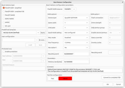

I have installed it and run a flash test there, output is:
### Check presence of FlashLoader ###
### Select FlexSPI NOR memory instance #1 using option on address 0x2000 ###

Hello, thanks for the information, I recommend open the example, modify the LUT for your memory and check the Quad mode to activate this register.
Pavel
4,501 Views
jakobczyk_woj
I don't see this example in SPT.
Also not sure what you mean regarding LUT and Quad mode.
I have tried with supplied binary bootable_images/evkmimxrt1170_iled_blinky_cm7_QSPI_FLASH.bin but with the same result:

I have tried all the options in "Quad mode setting" in "Boot Memory Configuration" but none helped.
4,529 Views
jakobczyk_woj
Mass erase in SPT is not possible because it can't pass memory configuration with the same output as above.
