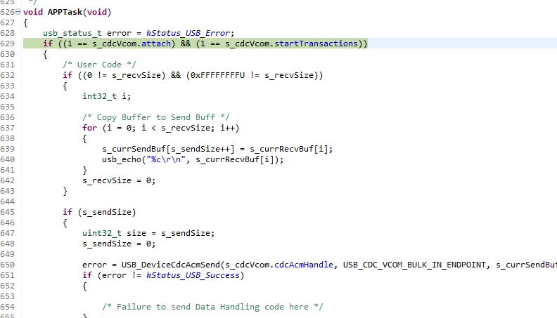

huy_dang
Hi Sabina,
usb_echo would only print to the IDE's console. I want to print it to the usb terminal that is reading the user input instead.
For example, if I add a usb_echo line to line 640 and print out the character being received through the terminal like this
I will see this on the IDE's console.

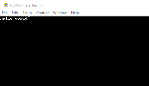

and here's the terminal that I want to print to instead.
The hello world right here is written when I type it in. Now I want to be able to print something else instead of just what I typed in.
I hope that clarifies it.
