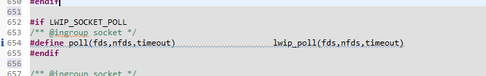

I have this compiler error I'm trying to narrow down in Mongoose:
   "error: macro “poll” requires 3 arguments, but only 2 given m->ifaces[i]->vtable->poll(m->ifaces[i], timeout_ms);"

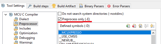

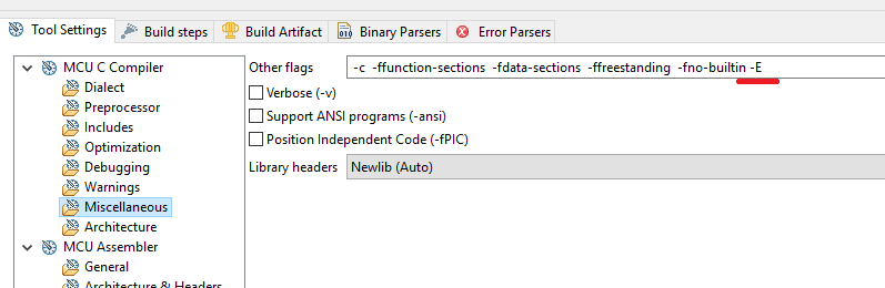

I need to see the pre-processor source with all the macros expanded so I can see where it's taking the definition of "poll" from. Typically, you would add -E to the compiler options. But I've done that, and I'm not seeing anything useful outputted.
How does one setup MCUxpresso to see the pre-processor source with all the macros expanded???

Hello Mike, I hope you're doing well,
I tested checking the "Preprocess Only (-E)" checkbox in my project settings and the output files are being generated correctly. Could you please look for those files inside your Debug folder?
You can find said folder here: workspace_folder\project_folder\Debug\source

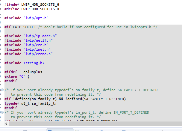

It turned up in a section of code, LWIP's sockets.h that is disabled by a #ifdef. So how is disabled code finding its way in?!
Whole sockets.h file should be turned off:

Got them, I needed "-save-temps". So now that I have all my .i files I'm still confused...

Obviously, the compiler is not going to "mistakenly" redefine a macro. There is obviously a definition of poll with 3 arguments in your source code.
The first, most obvious, way is to search for it (there are good search options in the IDE). Failing that, you could always define a poll macro yourself, which will cause the compiler to issue a macro redefinition error and should give you the source location of both macros.
