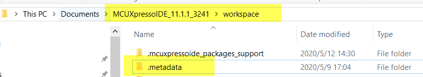

Hello  ATHMESH NANDAKUMAR,
If still have the issue, please try to delete .metadata folder under workspace:

myke_predko
Senior Contributor III
Delete with extreme prejudice - I suggest that you delete the folder and when you reinstall, put MCUXpresso in a folder with a different name.
You never know what Windows keeps around; if you want something deleted, kill it with fire.
