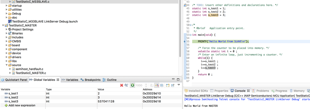

A bit more info, it seems there is initialisation but it is all shifted by -4 bytes:

I have attached a video of the problem here when setting up a Master/Slave project to show you what happens.

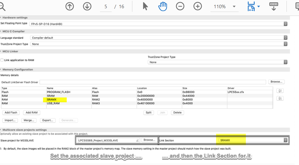

I suggest you follow this document to create new Slave and master project.
Make sure you build slave first then master.

I found one difference from you video, comparing with the manual. The link section is section name but not Alas. please check if this is the issue.
Besides, make sure you build the slave project before the master project. it's important.

Ok here is the issue:
This example is using 0x20022000 as the slave address.
If we look at the section headers for the slave axf we get:

We can see our .Text at 0x20022000 and our .data at 0x20026500

We can see that the .data_RAM2_core_m PROGBITS is correctly set to 0x20022000 for the slave .text.
The second .data_RAM2_core_m PROGBITS is incorrectly set to 0x200264fc instead of 0x20026500, 4 bytes out.
