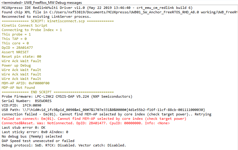

 I have encountered some issues while debugging in MCUXPresso with the LPC Link 2.
The problems occurred on Windows 10 with the MCUXPresso versions 11.0.0 and 11.0.1.
This is the error I get: "Em(01). Cannot find MEM-AP selected by core index (check target power)"
The complete error log is below:
I have got the same result with different LPC Link 2 debuggers and different boards.
Sometimes a reset (Windows restart, disconnect board and LPC-Link2, importing the project again in a new workspace) helps but most of the time it does not. And even if it works, after 1 debugging process it is back to the same issue again.

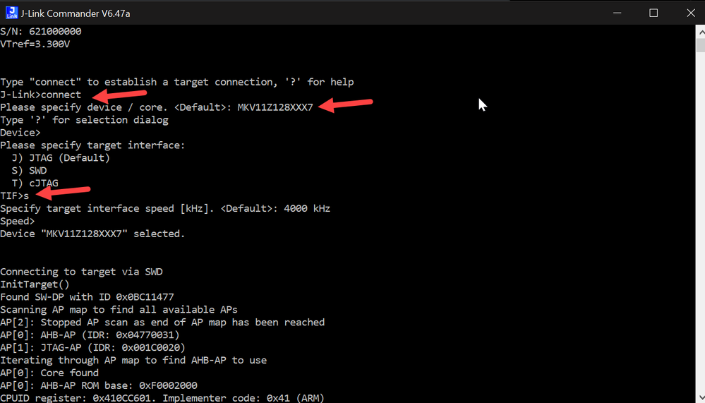

I will suggest to change the LPC-Link2 firmware from CMSIS-DAP to J-Link. After this use the J-Link console and try to connect to your MCU using this console. Check the commands bellow:

Dear Alexis,
I have programed the J-Link firmware onto my LPC-Link 2 and now everything seems to work again.
Thank you very much.
