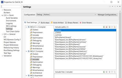

Hallo,
I'm using MCUXpresso IDE v11.0.0.
I have the following warning:
Invalid project path: Include path not found (\Project name\board). Location: pathentry Type: Path Entry Problem.

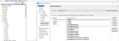

I checked in Properties->C/C++ General->Paths and symbols->GNU C and I have tthe following situation:
Could you please help me to remove the warning?
Many thaks in advance for you support.
Kinds Regards,
Chobin

have you checked the 'Path and Symbols' too?
8,108 Views
chobin
In 'Path and Symbols' I have the following:
Chobin

Check the directories listed with the -I option:
8,153 Views
chobin
Dear Erich,
thank you for your replay.
I checked the directories listed with the -I option and I found this:
I haven't fond the error.
Do you see it?
Many thanks for your support.
Kind Regards,
Chobin

You need to use
"${ProjName}/board"
Remove the leading slash.
Erich
8,134 Views
chobin
Dear Erich,
I wrote "${ProjName}/board", but the warning appears again.
I'm sorry, but I don't find the mistake.
Chobin
