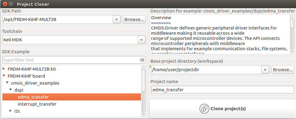

liborukropec
Hello Adib,
the MCUX Config Tools v4 can clone examples for Keil, GCC, etc. You need to
1) download SDK enabled for the toolchain you need and extract to a directory
2) launch MCUX Config tools, go to menu "Tools | Project cloner"
3) point "SDK Path" to the extracted SDK, select an example and a target path, click Clone project(s), done
Please note that creating <empty> project is not possible, only cloning an example. Anyway this should not block anyone to delete unwanted sources.
