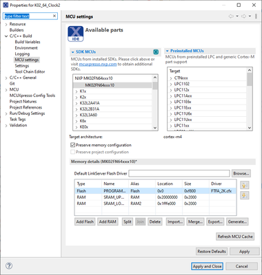

If it is only about the memory map/size, then you simply can go the the 'MCU settings' and change the memory size there:
But that way you always have to change the settings if you switch the device. Good for a one-off thing. Bad if you want or need to maintain both variants the same time.

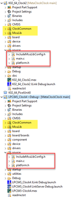

To give you an idea, how this looks likes, see https://github.com/ErichStyger/MetaClockClock or the screenshot below:
The yellow marked things are links to folders with all the common source code. The things in the red box are just the main() plus two configuration header files. Everything else is shared or anyway part of the MCUXpresso SDK setup. So about 99% of the source base is really shared, and the project only is a kind of container for the SDK (yes, with some of the SDK generated files). But all the application and driver files are inside McuLib and ClockCommon, and that way portable between systems.
As you can see with the above example: everything is under git/version control, and portable between M0+ (LPC) and different M4 MCUs. Up to the point that the application itself is very different across multiple platforms, with the full source base configured and shared between the projects :-).
And it gives you the ability to create production binaries, plus you can debug projects in parallel/etc.
