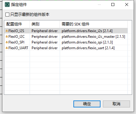

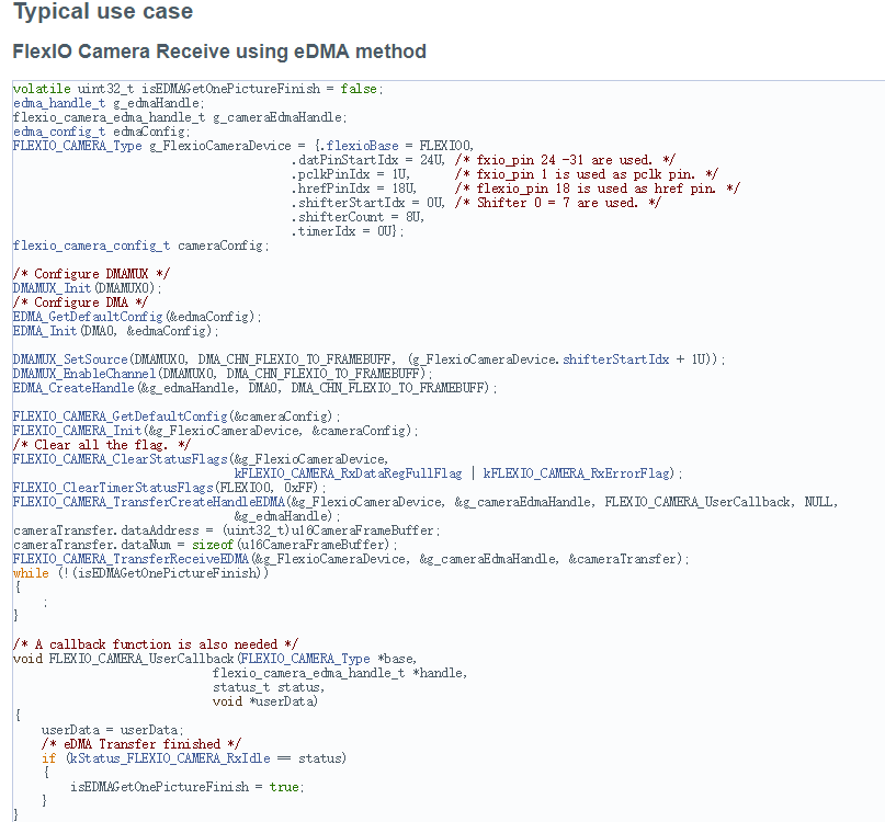

I'm using MCUXpresso Config Tool 5.0, MCUXpresso SDK V2.5 and a board with iMXRT1052. I just want to read data from a camera with 8 data pins, a HERF pin, a PCLK pin and a VSYNC pin. In SDK reference manual, there is a "FlexIO Camera Driver". But I can't find any files in SDK. There is no "FLEXIO_CAMERA_Type", no "flexio_camera_edma_handle_t", no functions about how to initialize the camera. The Config Tool can only initialize FlexIO as SPI, I2C, UART, I2S pin.
So how to use FlexIO as a camera driver with SDK?
Is there some diver files missing in the SDK?

The flexio interface is for Kinetis parts. Not sure this example has ported to i.mx RT .
The i.MX RT1050 processor has the special camera sensor interface (CSI) module, especially meant for parallel camera connection. So, there is no need of using FlexIO modules.
For the example of the CSI module use, please refer to the AN12110 Application note and the corresponding example, available on below link
https://www.nxp.com/docs/en/application-note/AN12110.pdf
