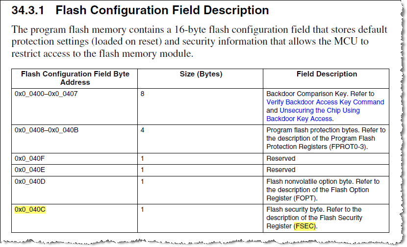

I found there is a flash configuration field setting. If the board is getting locked then I can not use the same board for multiple times. So, please anybody provides the location of field configuration setting in sample example project files.
I found many files that contain the flash configuration field related definitions in FRDM-K82F project folder files.

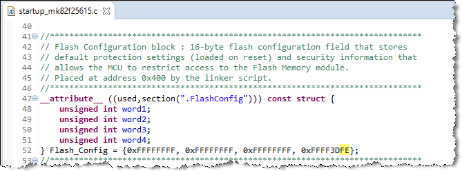

\startup\startup_mk82f25615.c
here search for Flash_Config = {0xFFFFFFFF, 0xFFFFFFFF, 0xFFFFFFFF, 0xFFFF3DFE};

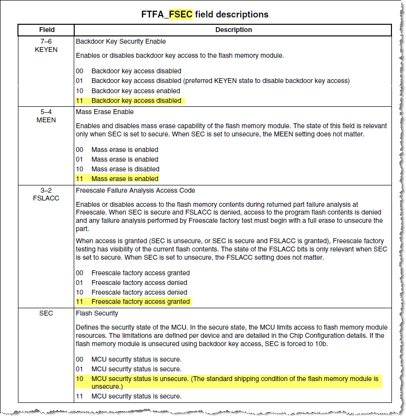

Hi isharat mahmood,
Modify the value of Flash_Config can be used to unprotect device (FRDM-K82F).
FTFA_FSEC = 0xFE
The default value of Flash_Config is unsecure and Mass erase enabled.
Robin
