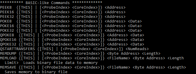

If you check the help from the RedLinkServer, there are some commands that could be useful:
You could give it a try.

james5
Thanks Alexis.  I did find that in the command line help.
