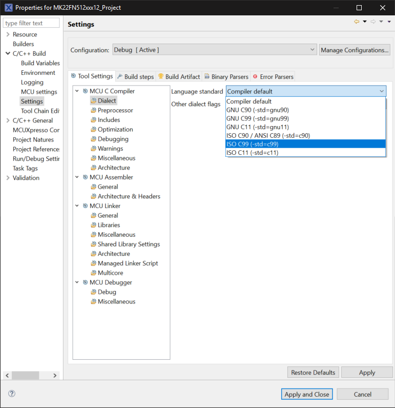

if I create a new SDK project (from the SDK project wizard), after selecting board and other configuration (device packages, project type, components...), I get "Advanced project settings" screen where I can select the MCU C Compiler. By default, "Language standard" points to "Compiler default", but I can choose if I want "GNU C90 (-std=gnu90).
However, if I create a new C project (not SDK), I can't see this screen and I can't choose "Language standard".
How can I change that?
Thanks.

Hi ptcaos,
If you right click in your project click in properties->C/C++ Build->Settings->MCU C Compiler->Dialect you can select the language:
