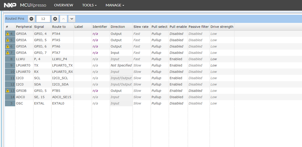

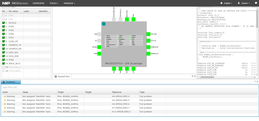

I am getting these warnings from the web-based pins tool. Anyone knows why I am getting these warnings and should I worry about them?

Hi Gaurav,
The warning will not affect right code generation.
From the warning description, you didn't define Identifier in Pin View. If you don't want it, simply define a name for Identifier, we can remove the warning
