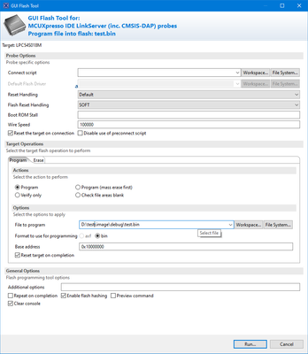

I am using the GUI Flash Tool on MCUXpresso 11.3.0 with LPC Link2 board to update spifi flash on a board with LPC54S018J4M MCU. The MCU board has a 6-pin SWD connection. The tag connect cable from https://www.tag-connect.com/product/tc2030-ctx-6-pin-cable-for-arm-cortex connects the LPC Link2 board to the MCU board.
I had trouble erasing or writing to the spifi flash in the MCU until I changed the wire speed to 100000. What is the max clock rate supported by LPC Link2? I didn't need to set the wire speed before. Not sure when this started happening. Can anyone provide some information to explain why this happened?

Hello rex_lam,
This wire speed maybe related to CMSIS DAP .
