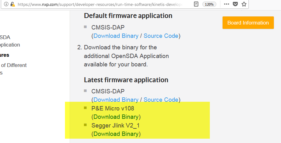

I thing I need to update Firmware Application
I am trying to connect TWR-KV58F220M on MCUXpresso IDE but it is not working.
I found
OpenSDA version / bootloader v2.1 / CMSIS-DAP
but the two links of Firmware Application is not working
Default firmware application CMSIS-DAP - Binary
Latest firmware application CMSIS-DAP - Binary
are broken.

I suggest you try P&E or Segger Jlink firmware.
OpenSDA Serial and Debug Adapter|NXP
How does it work?
