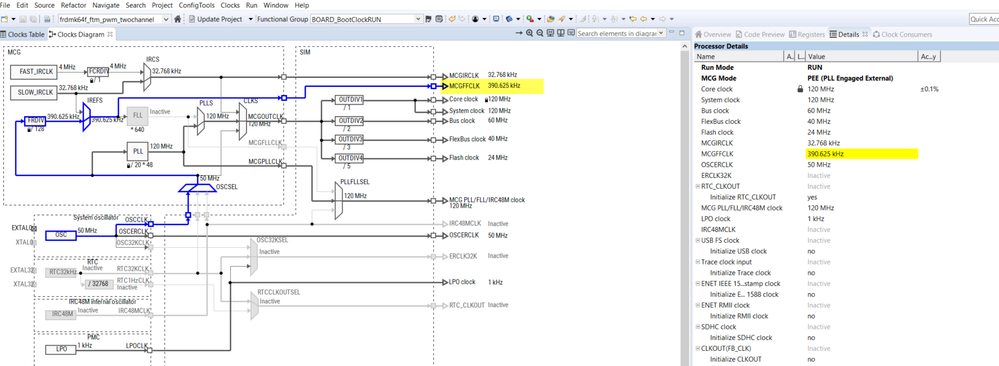

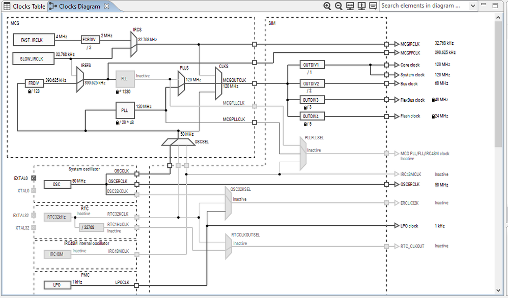

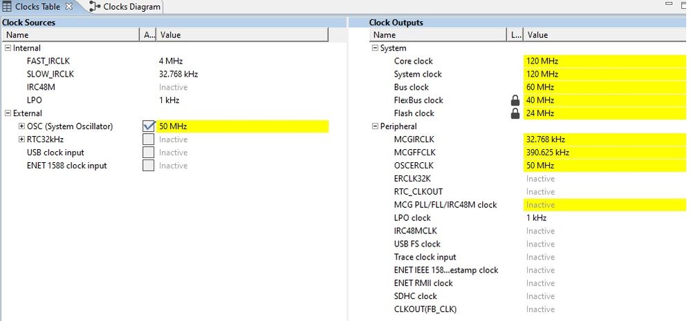

My problem is that the definition FTM_SOURCE_CLOCK is equal to 32552, but looking at my clock settings, the value of FTM_SOURCE_CLOCK should be 390625.
Below, is my clocks configurations.  Can you help me with this problem?
Thanks.

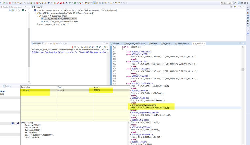

Hello Leandro Fabián Rocco ,
I test on my side, configure the MCGFFCLK to 390.625KHZ, then get the freq using:
 CLOCK_GetFreq(kCLOCK_McgFixedFreqClk);
the result is the same with Config tool:
You can send your project to me, I will help to check it .
