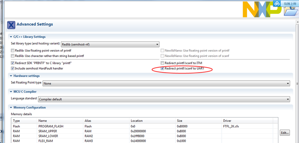

Now the output to my serial terminal emulator (Putty ) does not make sense. Am running a basic "Hello, world " demo and can't get any meaningful print out tho the MCUexpresso console shows the correct output.
How do I fix this... by the way I have tried Tera Term emulator and its the same bad outcome.
Kofi
15,395 Views
Hello Kofi,
When import the SDK demo code, please check "Redirct printf/scanf to UART, also config the
right baud rate 115200 for your putty :
Hope it helps
