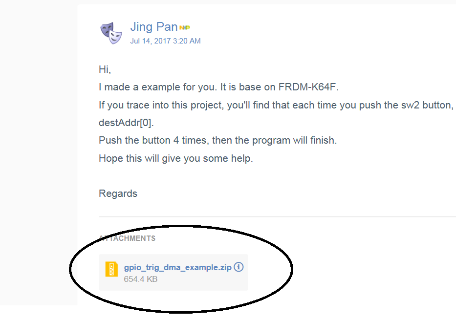

jingpan
I made a example for you. It is base on FRDM-K64F.
If you trace into this project, you'll find that each time you push the sw2 button, DMA will move a data from srcAddr to destAddr[0].
Push the button 4 times, then the program will finish.
Hope this will give you some help.

mikaelelharrar
Jing Pan please attach your project ...
7,109 Views
mikaelelharrar
Thank you very much, but where is the project ? Need I to generate a new FRDM framework from MCUxpresso ?
